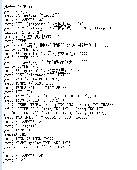

内容简介: (defun C:CM ()
(setq A nil)
(setq OM (getvar "OSMODE"))
(setvar "OSMODE" 33)
(setq PNT1 (getpoint "\\\\n方向起点: "))
(setq PNT2 (getpoint "\\\\n方向终点: " PNT1))(terpri)
(initget 1 "M E N")
(prompt "\\\\n选择复制方式: ")
(setq CTYPE
(getkword "[最大间距(M)/精确间距(E)/数量(N)]: "))
(if (= CTYPE "M")
(setq SP (getdist "\\\\n最大对象间距: ")))
(if (= CTYPE "E")
(setq SP (getdist "\\\\n精确对象间距: ")))
(if (= CTYPE "N")
(setq SP (getreal "\\\\n对象数量: ")))
(setq DIST (distance PNT1 PNT2))
(setq ANG (angle PNT1 PNT2))
(setq TEMP1 (/ DIST SP))
(setq TEMP2 (fix (/ DIST SP)))
(setq INC1 SP)
(setq INC2 (/ DIST (+ 1 (fix (/ DIST SP)))))
(setq INC3 (/ DIST (- SP 1)))
(if (= TEMP1 TEMP2) (setq INC INC1) (setq INC INC2))
(if (= CTYPE "E") (setq INC INC1) (setq INC INC))
(if (= CTYPE "N") (setq INC INC3) (setq INC INC))
(setq TMS (FIX (+ 0.00001 (/ DIST INC))))
(setvar "OSMODE" 0)
(setq A (ssget))
(setq INCR 0)
(repeat TMS
(setq INCR (+ INCR INC))
(setq NEWPT (polar PNT1 ANG INCR))
(command "copy" A "" PNT1 NEWPT)
(setvar "OSMODE" OM)
(setq A nil)
